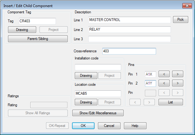

Insert a child component
  1. Click Schematic tabInsert Components panelInsert Components drop-downIcon Menu. Find
  2. In the Insert Component: JIC Schematic Symbols dialog box, click Relays/ Contacts.
  3. In the JIC: Relays and Contacts dialog box, click Relay NO Contact.
  4. Respond to the prompts as follows:
    Specify insertion point:
     Position the cursor on the wire at line reference 404 near the hot wire and click (1)
    The Insert/Edit Child Component dialog box displays. Notice that AutoCAD Electrical toolset did not automatically assign a tag name for the relay contact; there is just a generic “CR” in the edit box. Determine the relay contact tag name. A relay contact is a child component that must link to a parent relay coil on a drawing in the active project. The child gets the same tag name that is found on the parent relay coil.
    Assign the tag name by clicking Parent/Sibling and picking the parent in the drawing. Or, click Drawing or Project to select from a list of components with the same family name.

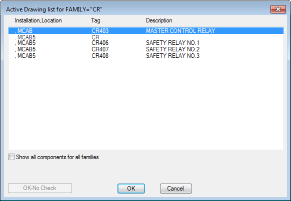

  5. In the Insert/Edit Child Component dialog box, Component Tag section, click Drawing.
  6. In the Active Drawing list for FAMILY=”CR” dialog box, select:
    MCAB5 CR403 MASTER CONTROL RELAY
  7. Click OK.
    The values of the parent are immediately transferred to the contact.
  8. In the Insert/Edit Child Component dialog box, verify that the following options are specified:
    Component Tag:  CR403
    Description: Line 1:  MASTER CONTROL
    Description: Line 2:  RELAY
    Cross-reference:  403
    Location code:  MCAB5
    Pins: Pin 1:  A1X
    Pins: Pin 2:  A1Y
  9. In the Insert/Edit Child Component dialog box, click OK.
    The child component is inserted. It is cross-referenced in real time. The coil is annotated with the line reference number of the new child contact. The child contact gets annotated with the line reference location of the parent coil.
