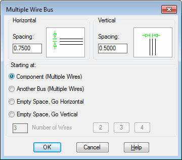

  4. Click Schematic tabInsert Wires/Wire Numbers panelMultiple Bus. Find
  5. On the Multiple Wire Bus dialog box, specify:
    Horizontal Spacing:  0.75
    Vertical Spacing:  0.50
    Starting at:  Component (Multiple Wires)
  6. Click OK.
