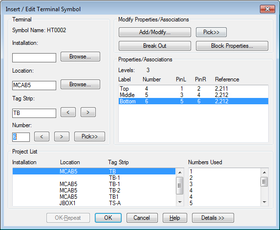

  3. Right-click terminal 6 and select Edit Component.
    On the Insert/Edit Terminal Symbol dialog box, Properties/Associations section, all three levels have been assigned. You can now move a terminal to another level using the Add/Modify Association dialog box.
  4. On the Insert/Edit Terminal Symbol dialog box, Modify Properties/Associations section, click Add/Modify.

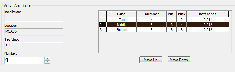

  5. On the Add/Modify Association dialog box, Active Association section, highlight level 3 in the grid and click Move Up.
    The grid updates to reflect the move. Notice that terminal 6 is now assigned to level 2.
  6. Click OK.
  7. On the Insert/Edit Terminal Symbol dialog box, click OK.
