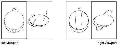

Project
Specifies the projection method used when trimming objects.

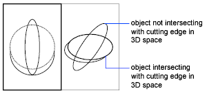

None
Specifies no projection. The command trims only objects that intersect with the cutting edge in 3D space.

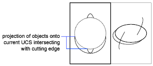

UCS
Specifies projection onto the XY plane of the current UCS. The command trims objects that do not intersect with the cutting edge in 3D space.
View
Specifies projection along the current view direction. The command trims objects that intersect the boundary in the current view.
