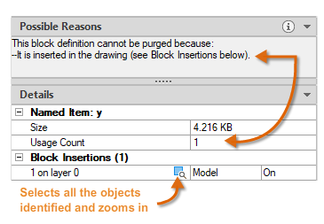

The Purge feature has been revised for easier drawing cleanup and organization. The control options are nearly the same, but the orientation is more efficient and the Preview area is now resizable.
These two controls determine whether the Purgeable Items or Find Non-Purgeable Items display when the Purge dialog box opens.
PURGE - Opens the redesigned Purge dialog box.

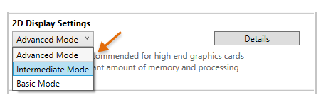

AutoCAD LT now launches correctly with different DirectX drivers (Dx9, Dx11, or no driver), high resolution (4K) monitors, and dual monitors. In addition, the graphics display settings are consolidated into three modes, which includes gradient hatches and images. The graphics performance setting, Intermediate Mode, is updated to reset several display parameters automatically to optimize your display.
Enter GRAPHICSCONFIG at the Command prompt.
The Graphics Performance dialog box displays, shown in part below.
GRAPHICSCONFIG - Revised 2D Display Settings as displayed in the Graphics Performance Dialog Box.
-GRAPHICSCONFIG- Revised command line options that support the new 2D Display Settings.
