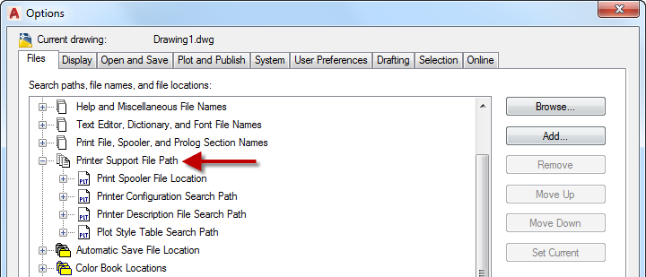

User profiles also include the locations in which the program searches for support, driver, customization, and other files. If your customized files are placed in locations other than the default locations, the paths to those locations are migrated, but the customized files themselves will not be migrated. Use the options of the Migrate Custom Settings utility to migrate your customized files, or manually copy the files between the locations of the previous and current release of the program.

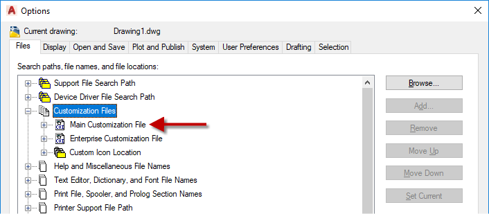

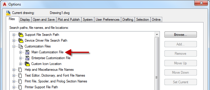

Customization (CUI/CUIx) files define user interface elements such as the Quick Access toolbar (QAT), ribbon panels and tabs, palettes, “classic” toolbars, and pull-down menus. Based on the previous release from which you are migrating, the Migrate Custom Settings utility looks for the CUI or CUIx file specified by the Main Customization File setting. The main customization file is migrated in addition to the partial customization files loaded in the main CUI/CUIx file.

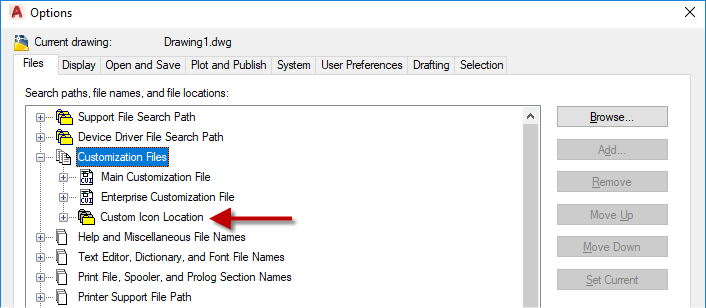

				Many user interface elements display a custom image, that custom image is migrated when the command or user interface element that custom image is migrated between CUIx files. Custom images referenced by commands and user interface elements defined in a CUIx file are stored in one of two locations: inside of the CUIx file or externally in the location defined by the Custom Icon Location setting. Based on how a custom image is referenced, the process used to migrate that custom image is different.
The following explains how custom images are migrated:

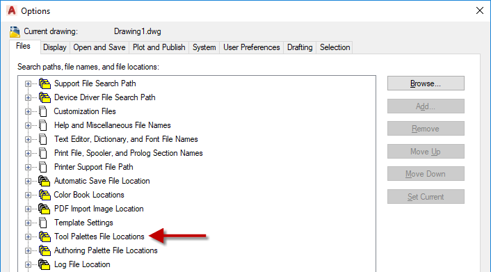

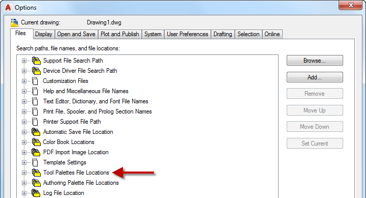

			 Tool palette files contain standard and user-defined tools. The files are stored in the locations specified by the Tool Palettes File Locations setting.
				When migrating tool palettes, custom tool palette groups are also migrated and merged with the default tool palette groups in the current release.

Plot files store various settings that control the output of a drawing file, including those for plotters and printers and that control the appearance of the linework in the output.

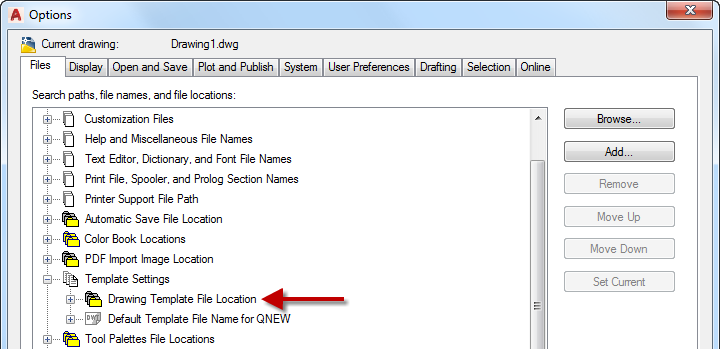

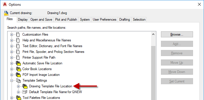

			 Drawing template (DWT) files are used to create new drawings. The drawings created using a DWT file contain all of the styles and drawing objects defined in the DWT file. The custom DWT files from the previous release are migrated into a subfolder named after the release in which they were migrated; the naming convention of the subfolder is Product Name Templates. The Product Name Templates subfolder is created under the folder defined by the Drawing Template File Location setting.

					  *.cui  |
					  Contains customization from AutoCAD 2006-based products through AutoCAD 2009-based products.  |
					  The customization file itself is not migrated; a copy of the file is created and then converted to a CUIx file with the same name. The new CUIx file is stored in the same folder as the main CUIx file for the current release. Enterprise CUI files are not automatically migrated, you must do so manually. The reference to the enterprise CUIx file is migrated.  |
					  *.cuix  |
					  Contains customization from AutoCAD 2010-based products and later.  |
					  User created customization files are migrated when they are designated as the main CUIx file or a partial customization file of the main CUIx file. The file is copied to the location of the main CUIx file in the current release and then migrated, unless the CUIx file is in a network location. If the CUIx file is in a network location, the file is not copied and its references are migrated only Enterprise CUIx files are not automatically migrated, you must do so manually. The reference to the enterprise CUIx file is migrated.  |
					  acad.cuix (AutoCAD-based products) acadlt.cuix (AutoCAD LT)  |
					  Contains standard customization from AutoCAD 2010-based products and later.  |
					  The customization file itself is not migrated; however, any changes made to the file are migrated to the CUIx file of the same name in the current release. If the CUIx file is designated as the enterprise CUIx file, the file is not automatically migrated, you must do so manually. The reference to the enterprise CUIx file is migrated.  |

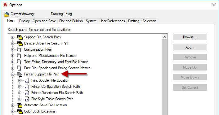

					  *.pc3  |
					  Contains the settings of virtual and physical output devices.  |
					  The plotter configuration file itself is not migrated; a copy of the file is created under the subfolder named Product Name PC3 Files.  |
