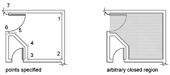

Define an Area
You can measure an area enclosed by the points you specify. The points must lie on a plane parallel to the XY plane of the current UCS.
