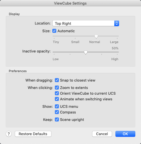

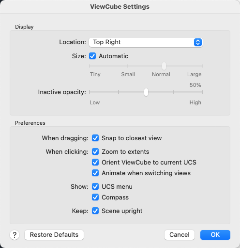

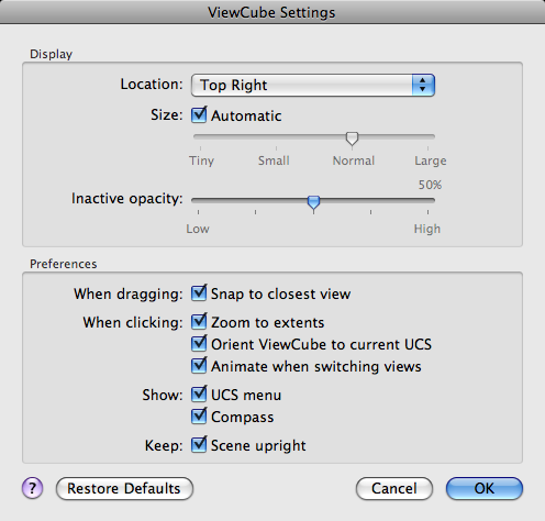

ViewCube Settings Dialog Box
Controls the display properties of the ViewCube tool.
OPTIONS (Command)
Menu: AutoCAD 2020 > Preferences > Look & Feel tab > Navigation Controls: ViewCube Settings
List of Options
The following options are displayed.
Display
Location
Identifies the corner in a viewport where the ViewCube tool is displayed. (NAVVCUBELOCATION system variable)
Size
Specifies the size of the ViewCube tool. (NAVVCUBESIZE system variable)
Select Automatic to have the size of the ViewCube tool adjust based on the current size of the active viewport, zoom factor of the active layout, or drawing window.
Inactive Opacity
Controls the opacity of the ViewCube tool when inactive. (NAVVCUBEOPACITY system variable)
When Dragging
Snap to Closest View
Specifies if the current view is adjusted to the closest preset view when changing the view by dragging the ViewCube tool.
When Clicking
Zoom to Extents
Specifies if the model is forced to fit the current viewport after a view change.
Orient ViewCube to Current UCS
Controls whether the ViewCube tool reflects the current UCS or WCS. (NAVVCUBEORIENT system variable)
Animate When Switching Views
Controls the use of smooth view transitions when switching between views.
Show
UCS Menu
Controls the display of the UCS drop-down menu below the ViewCube tool.
Compass
Controls whether the compass is displayed below the ViewCube tool. The North direction indicated on the compass is the value defined by the NORTHDIRECTION system variable.
Keep
Scene Upright
Specifies whether the viewpoint of the model can be turned upside-down.
Restore Defaults
Applies the default settings for the ViewCube tool.
