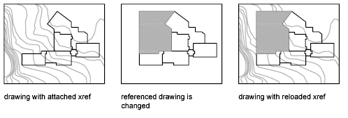

When you open a drawing, all drawing references (xrefs) update automatically. You can also update xrefs whenever you want to ensure that the most current versions are displayed in your drawing.
When you open a drawing, all xrefs update automatically. Use the Refresh Content (Reload) option from the Reference Manager to update xrefs whenever you want to ensure that the most current versions are displayed in your drawing.
Whenever you modify and save an externally referenced drawing in a network environment, other people can access your changes immediately by reloading the xrefs in their open drawings.
