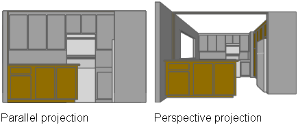

The following illustration shows the same model in both a parallel projection and perspective projection. Both are based on the same viewing direction.
