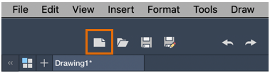

After you launch AutoCAD, click Create tab > New > Open on the Welcome screen to begin a new drawing.
AutoCAD includes a tool set to the left of the drawing area. You can access nearly all the commands presented in this guide from the Drafting tab. In addition, the toolbar above the drawing area includes familiar commands such as New, Open, Save, Print, Undo, and so on.

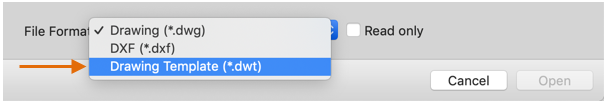

You can save any drawing (.dwg) file as a drawing template (.dwt) file. You can also open any existing drawing template file, modify it, and then save it again, with a different filename if needed.
If you work independently, you can develop your drawing template files to suit your working preferences, adding settings for additional features as you become familiar with them.
To modify an existing drawing template file, click Open, specify Drawing Template (*.dwt) in the Select File dialog box, and choose the template file.

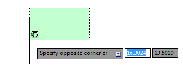

Press Esc to cancel this preselection operation.
