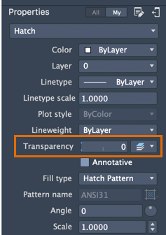

If you set a hatch pattern to be a solid or gradient fill, also consider setting a transparency level for interesting overlap effects. To set the transparency, select the hatch object and adjust the slider on the Properties Inspector.
Note: The Properties Inspector is covered in the Properties topic.

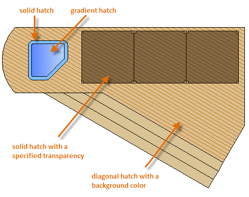

Here are some examples of how you can use solid-fill hatches:
Note: If an area is not completely enclosed, red circles display to indicate places to check for gaps. Enter REDRAW in the Command window to dismiss the red circles.
If you need to align the pattern in a hatch, which might be the case with the decking boards above, hover over the hatch's origin grip, and select Origin Point to specify an alignment point.
