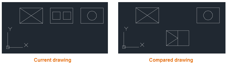

For example, let's say you need to compare the differences between two highly complex drawings that have been simplified to look like the following:
The result of comparing the current drawing with the compared drawing looks like this:
The change sets are each surrounded by orange revision clouds, which are scaled to the drawing extents.

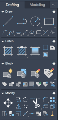

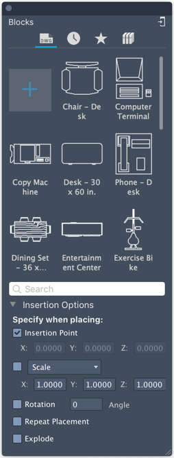

The Content palette has been updated and is renamed Blocks.
Click one of the new icons to switch between the following:
Blocks in the current drawing
Recently inserted or created blocks. The list of recent blocks persists across drawings and sessions.
Blocks marked as favorites
Selected block library
Do one of the following to place a block from the palette:
Before inserting a block from any view, set insertion options like Insertion Point, Scale, Rotation, Repeat Placement, and more. When Repeat Placement is checked, press Esc to exit the command.
To search for a block on the palette, enter a text string in the search box. Only the blocks with names that contain the text string are displayed in the Blocks list. Search results include blocks from the current drawing, recently used, favorites, and the active block library.

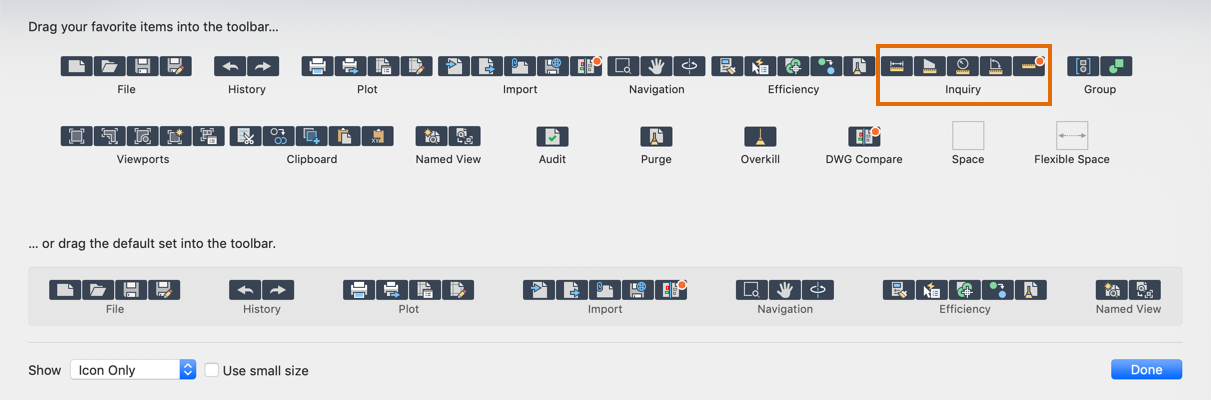

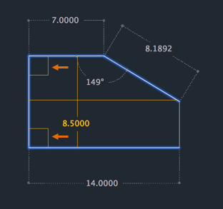

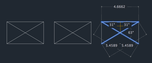

Measuring has become much faster with the new Quick option of the MEASUREGEOM command. With this option, you can quickly review the dimensions, distances, and angles within a 2D drawing.
When this option is active, the command displays dimensions, distances, and angles within a 2D drawing dynamically as you move your mouse over and between objects. The orange squares displayed at the left side of the illustration represent angles at precisely 90 degrees.
The distance between the two objects is measured in the illustration below because they're parallel.
You can also add MEASUREGEOM with the Quick option to the toolbar.
MEASUREGEOM - Adds the Quick option for real-time measurements.

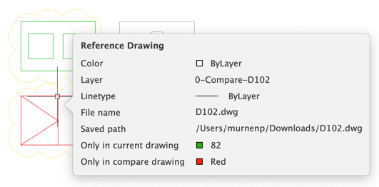

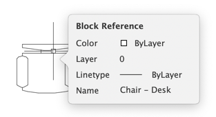

Rollover tooltips display current values of certain properties when the cursor hovers over an object in the drawing area. The following properties are included:
During a drawing compare, the rollover tooltip includes the following additional information:

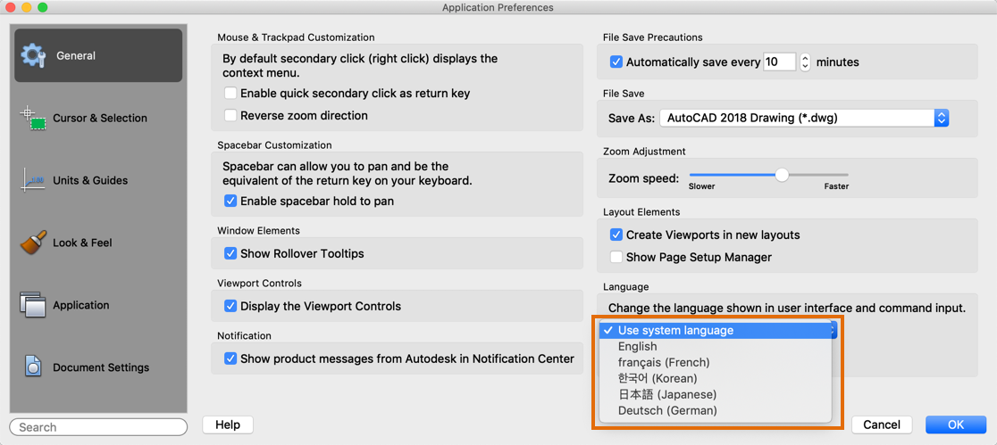

Control the display of rollover tooltips with . You can also set the display with the new system variable, ROLLOVERTIPS.
OPTIONS (General Tab) - Controls the behavior of program features, including the new option to display Rollover tooltips.
ROLLOVERTIPS - Controls the display of rollover tooltips when the cursor hovers over an object. Rollover tooltips are displayed for objects in the drawing area when the ROLLOVERTIPS system variable is set to 1.
AutoCAD for Mac now supports Korean. You can change the language in the Application Preferences dialog. Restart AutoCAD for Mac to see the language change.
