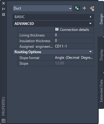

Advanced properties are collapsed by default. To view advanced properties, click
(Down arrow).
Advanced properties (includes duct flex properties)
| Property | Description |
Connection details |
Click Note: For more information, see Duct Connectors.
| Lining thickness |
Specifies the lining thickness of the current duct segment. |
Insulation thickness |
Specifies the insulation thickness of the current duct segment. |
** Takeoff Position |
Click Note: For more information see Modifying the Takeoff Position of a Duct Fitting.
| ***Assinged Engineering ID | Specifies the engineering ID of duct segment and fitting used for duct fabrication. |
**Vanes |
Turns Vanes On or Off. |
| Routing | Description |
*Slope format |
Displays the current slope format (not editable). |
*Slope |
Specifies the slope value of the current duct segment (not editable). |
| Flange dimensions | Description |
| * Flange extension | Specifies the extension of the flange. The flange extension value depends on the shape of the duct. Duct segments and fittings use the same values if the shape is the same. |
| * Flange thickness | Specifies the thickness of the flange. The flange thickness value depends on the shape of the duct. Duct segments and fittings use the same values if the shape is the same. |
| Graphics | Description |
**Graphics |
Specifies the pattern for flexible duct. Note: For more information, see Drawing Flexible Duct.
**Pitch |
Specifies the pitch value for flexible duct. Note: For more information, see Drawing Flexible Duct.
| Geometry | Description |
**Geometry |
Used when you modify the layout of flexible duct. |
