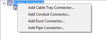

Use this procedure to add connectors to a block-based MvPart. Defining connectors allows the part size to be connected intelligently to other building systems objects in a drawing. You can define one or more connectors for each part size of an MvPart. You can assign each connector unique part properties, such as domain, system type, shape, and size. Generally, a part has at least one connector. However, you can create a part that has no connectors. For more information, see Connectors of a Block-Based Part.
Shows example of context menu for part family

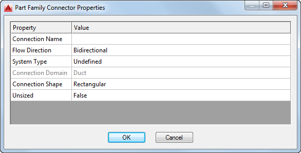

The Part Family Connector Properties dialog box is displayed.
| To specify the… | then click the value cell and… |
| Name | enter a descriptive name. |
| Connection Shape | select a shape from the list. The available shapes are dependent on the domain of the connector. |
| additional properties, such as Flow Direction | select from the list. Additional properties that are available are dependent on the domain of the connector. |
| Unsized | select True or False. Selecting True allows the connector to be unsized and valid connections to be made with unsized segments. |
These properties are assigned to the connector for all part sizes.

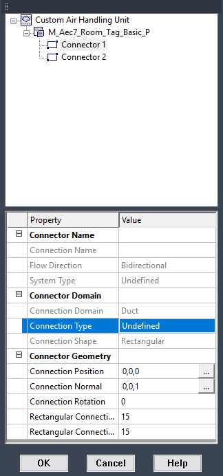

A property palette is displayed.
Example of connector property palette
| To specify the… | then… |
| position of the connector | enter p (position), or click |
| direction to draw connecting components by a single point | enter n (normal), or click |
| direction to draw connecting components by 2 points | enter n (normal), select the first point, and then select the second point. The connection normal is updated in the palette. |
| type of connection | in the property palette, select a type for Connection Type. |
| rotation of the connector | in the property palette, enter a number of degrees for Rotation. Typically, the rotation value is 0 (zero). |
| size of the connector | in the property palette, enter a number for the size properties. The size properties vary depending on the shape of the connector. |
