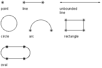

Content Builder provides 9 types of geometry you can use to build the model:
Defined by an X and Y coordinate.
Defined by a position and a direction; constrained by a start point and endpoint.
Defined by a position and a direction; infinite in length because it has no constraining start point or endpoint.
Defined by a center point and a radius.
Defined by a center point and a radius; constrained by a start point and endpoint.
Defined by lines and points that are constrained to maintain start points and endpoints for each side and perpendicular angle.
Defined by lines, arc, and points that are constrained to create 2 arcs tangent to 2 lines, with defined start points and endpoints.
Defined by a point in the work plane that is based on a source point selected from a different work plane. A point reference is moved or deleted with the source point.
Defined by a projection of a modifier on a specified work plane. The project geometry is fixed and cannot be moved in the work plane. It is linked to the modifier and adjusts as the modifier changes.
