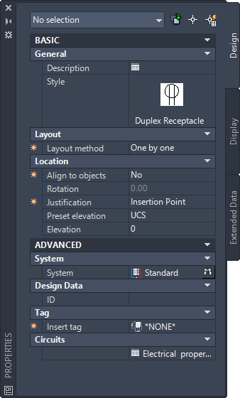

Specify general properties
- On the Properties palette, if necessary, double-click on the device display to open the style selector dialog box.
- For Description, click
, enter a description of the device, and click OK.

- If you selected One by One for Layout Method, expand Location, and for Align to objects, specify how you want to align the devices:
| If you want to…
then…
| snap to an object using object snaps and have the software align the device perpendicular to the object
select Yes.
The software can align the device perpendicular to a wall, ceiling grid, space boundary, line, polyline, spline, arc, or circle in the current drawing or in an xref.
Note: If you have difficulty snapping and aligning to an object, zoom to the area or modify the size of the AutoSnap aperture as needed. The aperture size determines how close to a snap point you can be before the magnet locks the aperture box to the snap point. You can modify the size on the Drafting tab of the Options dialog box.
| manually align the device
select No.
Note: If you select Yes for Align to objects, the software inserts the device using the insertion point of the underlying block and rotates it as needed to align it perpendicular to the object to which you snap. As a result, you cannot specify a value for Justification on the Properties palette, or a value for Rotation on the command line. If you selected Distance around space or Quantity around space for Layout method, Align to objects is automatically set to Yes.
- For Justification, select the point on the device to use as the insertion point.
You can select either the insertion point of the view block that represents the device, or one of 9 other points on the device, such as Top Left or Middle Center.
- Specify an elevation by doing one of the following:
- For Preset Elevation, select a defined elevation.
- For Elevation, enter an elevation.

- Expand Advanced, expand System, and for System, select the system to which the device belongs.
Note: The system assigned to the device determines its display properties, and the system assigned to an electrical connector on a device determines the connections that can be made to the connector. For more information about connectors, see Configuring the Electrical Connectors of a Device. For more information about systems, see Configuring Electrical System Definitions and Working with Systems.
- Expand Design Data, and for ID, enter an ID for the device.
The ID is an optional number that you can assign.
- Expand Tag, and for Insert Tag, select the tag to anchor to the object.
The list of tags includes the tags in the current drawing and, if specified, the tag specified in the tool you selected.
A tag is a symbol that can display the data in a property set that is attached to the object. A property set is a user-defined group of related properties, such as a part number or a manufacturer’s name, which you can specify in the properties of a tag tool or manually attach to an object using the Extended Data tab of the Properties palette. You use property sets and tags to annotate drawings and create schedules for construction documents.
Tip: Instead of manually adding tags and property sets to devices one-by-one using the Properties palette, you can create device tools that automatically add them to devices when the devices are inserted. For more information, see Creating Tools for Devices, Panels, and Wires.
Specify connector properties
- Expand Advanced, expand Circuits, and click
Electrical Properties.
Note: You can edit Electrical Properties later by selecting a device in the drawing and clicking
- On the Electrical Properties worksheet, configure the electrical connectors, as explained in Configuring the Electrical Connectors of a Device.
