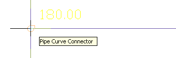

As you draw a plumbing system, sometimes you need to start or end a run by connecting (snapping) to the endpoint of an existing plumbing line, or to a point along its curve.
If the connecting plumbing line has a different elevation than the one you are starting or ending, you are prompted to decide how to connect the 2 plumbing lines:
If you are connecting to an end connector, the software inserts a drop symbol to represent the change in elevation. If you are connecting to a point on the curve of the plumbing line, the software inserts the tee specified as the default fitting for Tee Up or for Tee Down in the plumbing system definition, depending on the elevation of the 2 lines.
