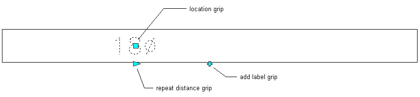

To modify a label using grips
| To… | Then… |
| add a label | click the Add Label grip. Hold down Ctrl while clicking to add labels at even spacing. |
| remove a label | click the Remove Label grip. You can remove individual labels regardless of the method used to add the labels. |
| move a label | click the Location grip and move the label to a new location along the curve. Press Ctrl after clicking the Location grip to offset the label from the curve. ![]() |
| add labels spaced at a specific distance along a curve | click the Repeat Distance grip, and click along the curve to specify a distance from the beginning of the curve to the selected point. Labels are added along the curve, and are spaced at this distance. |
| space multiple labels evenly along a curve | Hold down Ctrl and click the Repeat Distance grip. |
