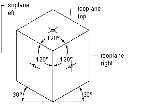

Isometric drawings simulate a 3D object from a particular viewpoint by aligning along 3 major axes. The Isoplane option on the Properties palette restricts cursor movement to appropriate rotated angles along isometric planes. You can work on one of 3 isometric planes, each with an associated pair of axes:
Viewing isometric planes
Choosing one of the 3 isometric planes causes the AutoCAD® Ortho mode and the crosshairs to be aligned along the corresponding isometric axes in the WCS. You can switch between planes as you draft. For example, you can start a run on the top plane, switch to the left plane to draw a riser, and then switch to the right plane to complete the run.
