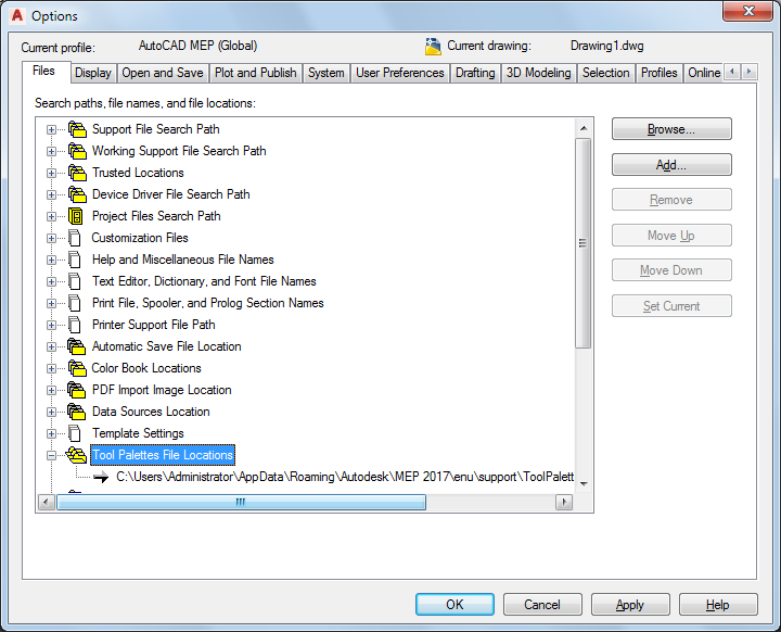

.The tool palette set is the collection of tool palettes specified for the current profile in the Tool Palettes File Locations setting.

If you are working in a project, the tool palette set also includes a tool palette group for the project. When you set a project as current, the software appends the AutoCAD
Tool Catalog (ATC) file location for the project-specific tool palettes to the path for the tool palette set. When you close the current project or set another one as current, it removes the project-specific tool palettes from the path.
