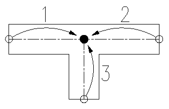

To add a trim length, you select valid node points that are displayed in the model and define a distance for the length. The following illustration shows how trim lengths for a tee fitting would be defined:
A tee has 3 trim lengths: 2 are defined from the center point of the trunk to each end of the trunk legs (1 & 2), and the third is defined from the center of the trunk to the end of the branch leg (3).
