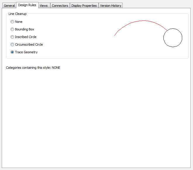

The design rules of a style determine how schematic lines, wires, and plumbing lines are cleaned up when they are connected to, respectively, schematic symbols, devices or panels, or plumbing fittings.
To specify the design rules of a style for cleaning up lines
| If you want to end at the… | then select… |
| connection point |
None. |
edge of a surrounding hidden box ![]() |
Bounding Box. |
edge of an inscribed circle within a surrounding hidden box ![]() |
Inscribed Circle. |
edge of a circumscribed circle outside a surrounding hidden box ![]() |
Circumscribed Circle. |
| at the edge |
Trace Geometry. |
Existing content that uses the style is updated automatically. By default, any new content uses the new method.
