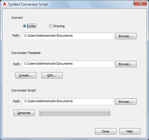

To create a symbol conversion script
.The software displays the Batch Convert Symbols dialog box.
| If you want to… | then… |
| convert the blocks in a single drawing | click Drawing, click Browse, select the drawing, and click Open. |
| convert the blocks in all drawings in a folder | click Folder, click Browse, select the folder, and click OK. |

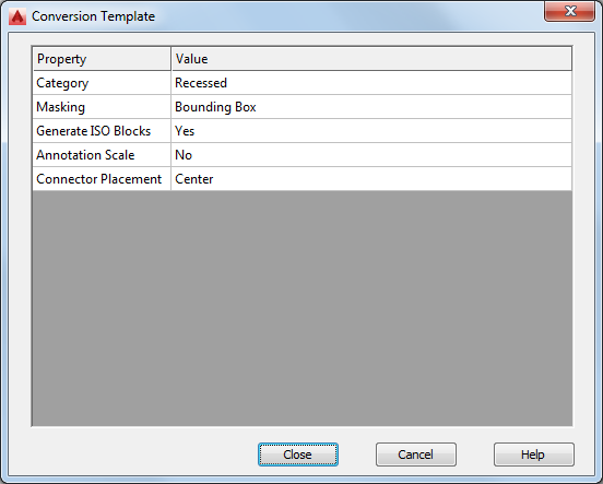

| create a template | click Create. In the Open File box, specify the location for the new template, and, for File name, enter its name. Click Save. In the Conversion Template dialog box, specify the values of the template settings. Click Close to return to the Symbol Conversion Script dialog box. |
| use an existing template | click Browse. In the Open File box, select the existing template, and click Open. Note: To make changes to the template prior to using it, click Edit. In the Conversion Template dialog box, modify the values of the template settings. Click Close to return to the Symbol Conversion Script dialog box.
| create a new conversion script | in the Select File dialog box, specify the location for the new script, enter a name, and click Save. |
| overwrite the contents of an existing script | in the Select File dialog box, select the existing script, click Save, and then click Yes to confirm that the contents of the script can be overwritten. |
