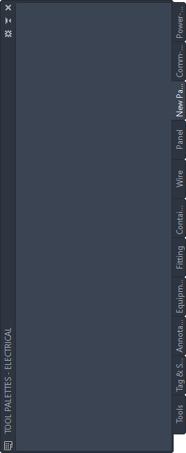

| create an empty tool palette set | specify the file location of an empty folder. Once you click OK in the next step, this results in a blank tool palette set, to which you can add palettes and tools. For more information, see Creating a Tool Palette and Customizing Tools. |
Empty tool palette set
