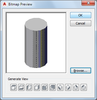

Use this procedure to generate a preview image of the parametric MvPart to help during part selection. Content Builder generates the preview image based on a specified view direction. You can select from the 10 standard AutoCAD® view directions to view the model (top, bottom, left, right, front, back, SW isometric, SE isometric, NE isometric, and NW isometric).
The Bitmap Preview dialog box is displayed.
Example of bitmap preview of a parametric vertical tank MvPart
You can also browse to and select a predefined bitmap image. Predefined images must be 200 x 200 pixels and saved with 256 colors.
