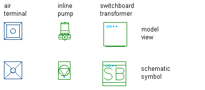

While parametric parts do not require schematic symbols, generally you create them for use in schematic diagrams. If a part does not have a schematic symbol, the part is not visible in schematic representations of a system. If a part does have a schematic symbol, you have the option of also using it in 1-line and 2-line representations of a system in Top (plan) view. This can be helpful for differentiating systems in a design, for example, supply and return HVAC systems.
Model and schematic representations of parts

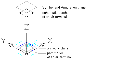

You create schematic symbols for parametric parts on the Symbol and Annotation plane, a horizontal plane to which you attach the symbol geometry, associated constraints and dimensions, and annotation.
Symbol and Annotation plane in the drawing area
Symbol and Annotation plane in the Content Builder part browser
In many ways, the Symbol and Annotation plane behaves like the work planes to which you attach the features of the part model. You attach the features of the symbol to the Symbol and Annotation plane, and you can make the plane visible or invisible, isolate its contents, or hide its contents. However, unlike the work planes that you create manually, the software automatically creates the Symbol and Annotation plane when you begin a new part in Content Builder.
As shown in the previous illustration, the default position of the Symbol and Annotation plane on the Z axis in the World Coordinate System (WCS) is high above the WCS origin. This keeps the plane and its contents out of the way while you are working on your part model. If desired, you can change the Z position of the plane. To do so, right-click the plane in the part browser, click Change Plane Position, enter a new value for the Z position, and press Enter.
