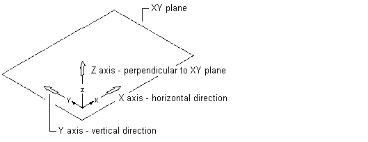

You can draw a schematic diagram in orthographic (plan) mode. Orthographic mode enables you to draw the diagram in a 2D plan view.
When you draw in orthographic mode, you add schematic lines and symbols in the world coordinate system (WCS). In the WCS, the X axis is horizontal, the Y axis is vertical, and the Z axis is perpendicular to the XY plane.
