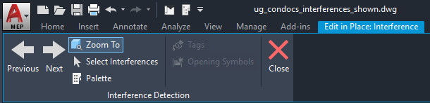

to start the analysis. When the analysis is completed, locate the Edit in Place tab on the ribbon to view the Interference Detection panel.
Use the information in the following table to help you view and resolve each interference:

| zoom to an interference | in the Interference Detection palette, select an interference Note: To zoom to an interference in the drawing by selecting it from the palette, enable zoom to mode by clicking Activate Zoom To.
| move between the interferences in the list view and in the drawing | click the Previous Interference and Next Interference buttons on the Interference Detection panel |
| automatically zoom to one or more interferences | click Zoom To on the Interference Detection panel to toggle zoom mode, and then select one or more interferences in the drawing |
