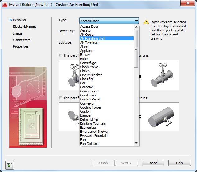

In the block-based building environment, you begin part definition by specifying the behavior of the part family. Every part size in a part family has the same behavior. You then specify a type, subtype, layer key, and insertion method for each part family.
Part type refers to the main category for the part family. It defines unique characteristics and behaviors for the part sizes, such as the ability to assign flow annotation to an HVAC part size. Types are predefined by the application and cannot be modified. Therefore, select a type that is similar to the part sizes.
Example of MVPart Builder (New Part) dialog box
Part subtype is the subcategory for the part family. It is useful for grouping similar parts. The subtype can be used as a filter method for part selection in the Add and Modify dialogs. Therefore, you should select a descriptive subtype name for easy identification. You can also enter a new subtype if the desired subtype is not listed.
