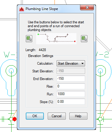

You can calculate the start elevation, end elevation, or slope of a plumbing line using the plumbing line slope tool.
To use the plumbing line slope tool, you need to enter at least 1 of the following values for the plumbing line to be calculated:
To calculate the slope of a plumbing line
. A green dot indicates the start of the selected plumbing line. A red dot indicates the end.
You can redefine the start point or the end point of the plumbing run.

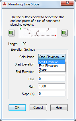

In the Plumbing Line Slope dialog, click Select Start Point of Run or Select End Point of Run.
| If you want to Calculate… | then enter… |
| Start Elevation | end elevation and slope |
| End Elevation | start elevation and slope |
| Slope | start elevation and end elevation |
