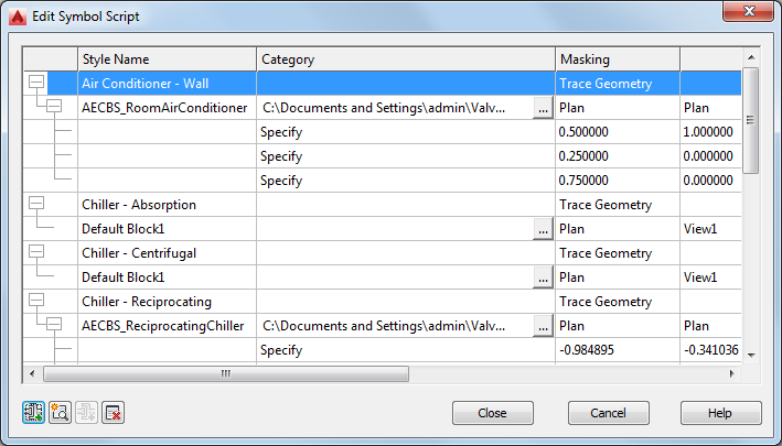

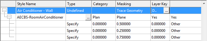

You modify a symbol conversion script using the Edit Symbol Script dialog box.

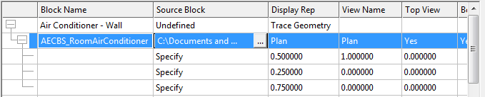

In the dialog box, the displayed settings change depending on whether you select a schematic symbol style, a view, or a connector in the table. For example, in the following images, notice how the heading names differ depending on the selected object.
Selected style
Selected view
Selected connector

| modify a view for a style | select the view, and modify its properties using the available options. For example, you might want to specify a different source AutoCAD® block for the view. To do so, you can modify the block definition in the drawing specified in the Source Block property, or you can specify the file path of a different drawing. |

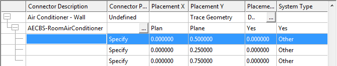

| modify a connector for a style | select the connector, and modify its properties using the available options. Note: If you are using a script generated using the Decompose Symbols command, you might need to specify a value for the Connector Placement property for some connectors. The script sets this property to Specify by default. You can select

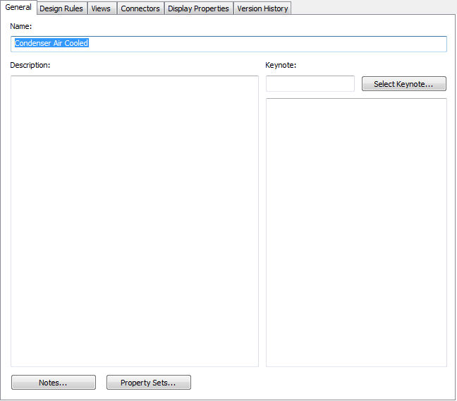

The Style Name property in the symbol conversion script displays on the General tab of the Style Manager. On the tab, the property is called Name.

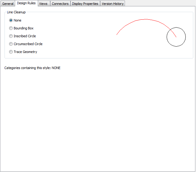

The Masking property in the script displays on the Design Rules tab of the Style Manager. On the tab, the property is called Line Cleanup.
The Category property in the script does not display in the Style Manager. Schematic symbol categories are the mechanism by which you group the symbols (symbol styles) in the Select Schematic Symbol worksheet, making it easier to browse the available symbols. You create and manage symbol categories directly in the worksheet.
If you enter a name in the Category property of the symbol conversion script, the software adds the symbol (symbol style) to the category. If the category does not exist, it is created in the style drawing. For more information, see Categorizing Style-Based Content.
The view properties in the symbol conversion script display on the Views tab of the Style Manager. On the tab, the Create ISO Blocks property is called Generate Isometric Views.
The Source Block property in the script does not display on the tab. When you create a style view using the Style Manager, you do not specify the file path of the drawing containing the source AutoCAD block, because you are limited to selecting a block in the current drawing.

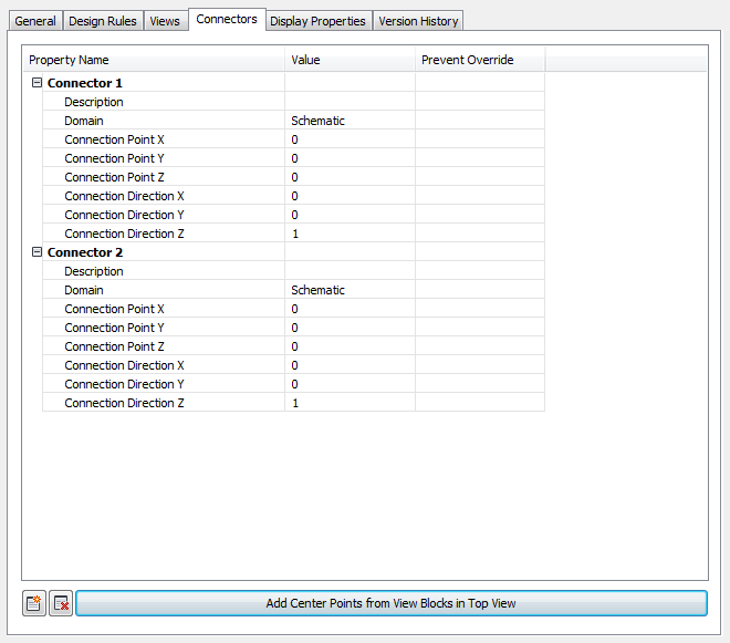

The connector properties in the script display on the Connectors tab of the Style Manager.
The Connector Placement property in the script does not display on the tab. In the Style Manager, you can only specify a connector position by entering the X, Y, and Z coordinates, or by placing the connector at the center of the block, using the options shown in the image.
