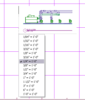

and specify a viewport window on the sheet. If you want to change the size of the view on the sheet, right-click and select a new scale.

To move the viewport on the sheet, select the viewport boundary and use the basic modify tools in the context menu. You can adjust the viewport size to change the viewable portion of the view drawing. You can also activate the model space view by double-clicking inside the viewport. After you activate the model space view, you can move or zoom the view drawing within the viewport. Double-click outside the viewport to deactivate the model space view and return to paper space. In paper space, you cannot modify the drawing within the viewport.
