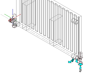

You use the alignment grip
 to connect an MvPart to another object by aligning their connectors and placing the MvPart in the correct orientation. The alignment grip lets you accurately move a radiator valve to another side of the radiator.
 The alignment grip only appears on an MvPart connector when you can move or realign the MvPart without affecting other connections. Otherwise, use the location grip
 on the connector to move the MvPart.

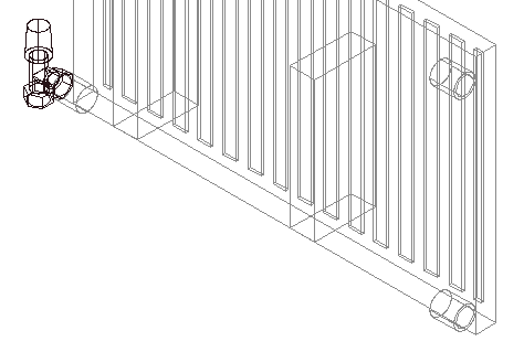

To move a valve to another connector and maintain alignment
This action moves the MvPart while staying in alignment with the original position.
