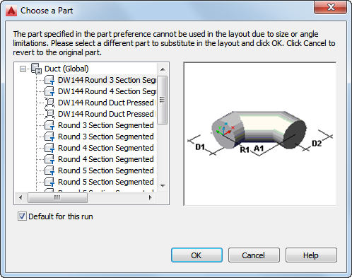

The Choose a Part dialog box displays if you try to add or modify a part in a run that is not stored in your preferences. You will be prompted to make a substitution from the catalog. The following example shows the dialog box in the Ductwork domain in the Global profile:
Choose a Part dialog box showing duct parts organized by shape type
The following table summarizes scenarios where the Choose a Part dialog box is displayed, prompting you for a part substitution:

If you modify a layout, the Choose a Part dialog box zooms to the part in the layout that requires action. After you make a selection, the original view is resumed. Your last preference for the specific domain is automatically retained until you change it. You also have the option to make the part selection the default.
The substitution you make only applies to the specific location in the layout. If you repeat this action while the Add command is still active, the dialog box prompts you to select a part again.
If the preferred part or connection type is unavailable, click Cancel and then add the desired fitting manually.
You might also be prompted to choose a part multiple times if you try to connect objects either with different connection types or whose centerlines are not aligned. In such cases, the parts you choose are automatically used to create one or more routing solutions.
