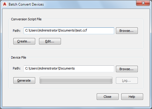

To convert a set of blocks to device styles
The conversion script contains the device style settings to use, as well as references to the drawings that contain the AutoCAD® blocks to use for the style views.
| If you want to… | then… |
| create a script | click Create, and create the script using the Device Conversion Script dialog box. For more information, see Creating Device Conversion Scripts. |
| use an existing script, such as a customized version of a script generated from converting existing device styles to blocks. | click Browse, select the script, and click Open. Note: To make changes to the script prior to using it, click Edit, and modify the script using the Edit Device Script dialog box. For more information, see Modifying Device Conversion Scripts.
| create the drawing | in the Select File dialog box, specify the location for the new drawing, enter a name, and click Save. |
| overwrite the contents of an existing drawing | in the Select File dialog box, select the drawing, click Save, and then click Yes to confirm that the contents of the drawing can be overwritten. |
The software creates the device styles using the conversion script and the block definitions from the referenced drawings.
