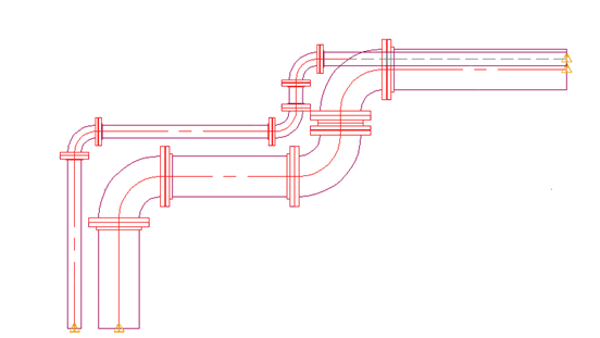

When using the PARALLELROUTING command to add parallel pipes, you might specify a point or a property value that causes a conflict between 2 of the pipes being routed. This situation generally occurs when you specify a small turn or a change in elevation while routing pipes with different diameters, as shown in the following illustration:
