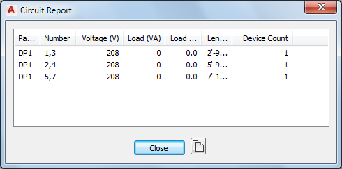

As you create schedules for your electrical design, you might find it helpful to view information about particular circuits in the drawing. In a circuit report, you can view the assigned panel name, circuit name, voltage, load (in VA), circuit length, and number of devices for one or more selected circuits.
You can copy the information in a circuit report to the Clipboard, and then paste it into another application, such as a spreadsheet or word processing application.
To generate a circuit report
