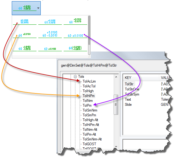

If the default representation of the fit or tolerance is not satisfactory, select another representation from a predefined set available in the Representation drop-down list or the Method drop-down list in the Power Dimensioning Ribbon Contextual Tab.
If the predefined set is inadequate, you can use the System Editor and create your own customized fit representations and tolerance methods. The information on this page explains the related System Editor entries and keys.

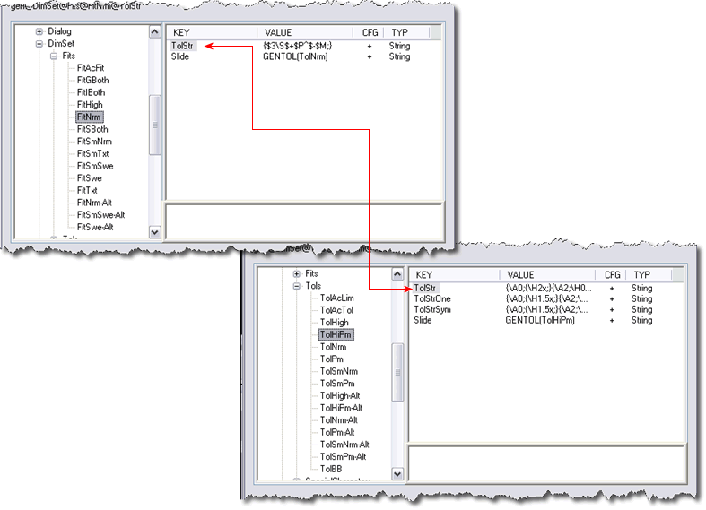

The thumbnails of tolerances in the Tolerance drop-down correspond to the first eight entries under Acad/M > DimSet > Tols, in the System Editor. The names of these entries begin with “Tol” (for example, TolHigh). The remaining entries refer to the alternative unit representation of tolerances; their names end with “-Alt.” For example, TolHigh-Alt is the alternative unit representation of TolHigh.
The entries under Acad/M DimSet
Tols, from top to bottom, correspond to the tolerance representations in the list, from left to right.

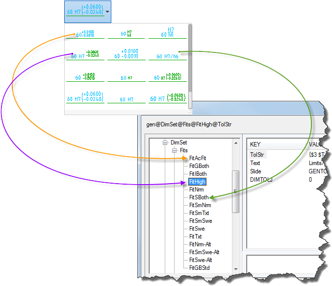

Like tolerances, the 12 representation in the list in the Fit Representations dialog box correspond to the first 11 entries under Acad/M > DimSet > Fits in the System Editor. The names of these entries begin with “Fit” (for example, FitNrm). The remaining entries refer to the alternative unit representation of fits; their names end with “-Alt.” For example, FitNrm -Alt, is the alternative unit representation of FitNrm.
Fits, from top to bottom, correspond to the tolerance representations in the Fit Representation list, from left to right.
The keys for the entries below “Fits” and “Tols” are the same, regardless of whether the entry is for a fit or a tolerance.
