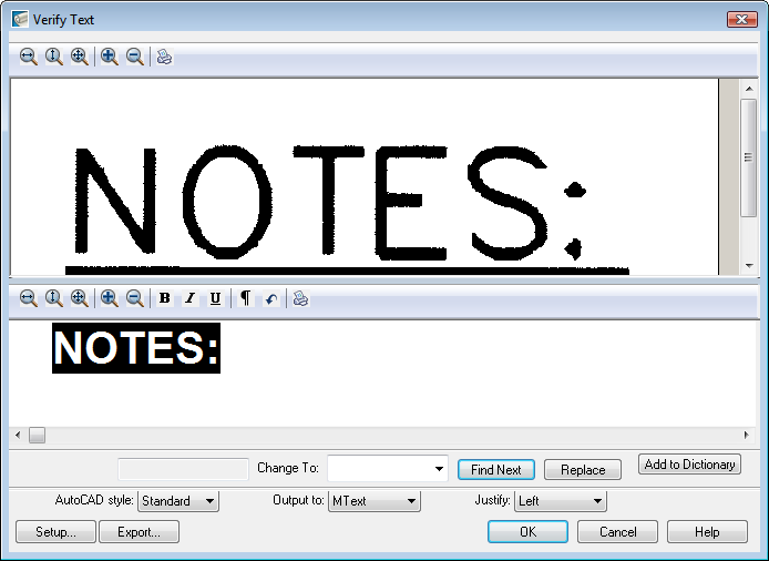

  11. Click Raster menu Text RecognitionRecognize Text.
  12. Draw a rectangle around the word “NOTES” as follows: click the upper left corner, press Enter to set the angle to 0, then click the bottom right corner.
    The Verify Text window displays the word NOTES: in both the View pane (upper pane) and the Edit pane (lower pane). If the word NOTES: is not underlined in the Edit pane, click and drag to select the word and click the underline formatting option on the Edit toolbar. If the recognition engine has inserted any unwanted characters, delete them from the Edit pane.
  13. Click OK to insert the word NOTES: into the drawing as AutoCAD Mtext.

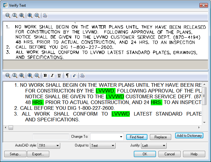

  16. Draw a rectangle around steps 1 through 3 as follows: click the upper left corner, press Enter to set the angle to 0, then click the bottom right corner.
    The Verify Text window opens. The View pane displays the original raster text; the Edit pane displays the output from the recognition engine.
  17. Review the areas of highlighted text in the Edit pane. Click Find Next to display the first suspect word or rejected character in the Change To box. Select a word from the Change To list or enter the correct word in the box and click Replace. Click Add to Dictionary if you want to add the word or acronym to the recognition dictionary. When you click OK, you are prompted to add the word to the AutoCAD custom dictionary too.
    Attention: Because no recognition engine is 100% accurate, you should carefully check the results in the Edit pane, not just the highlighted areas, and make all necessary changes.
  18. After making changes, click OK to insert the new AutoCAD text in the image.
    Tip: You can use the AutoCAD MOVE command to align the text block. To edit the text, select it, then right-click and click MText Edit.
