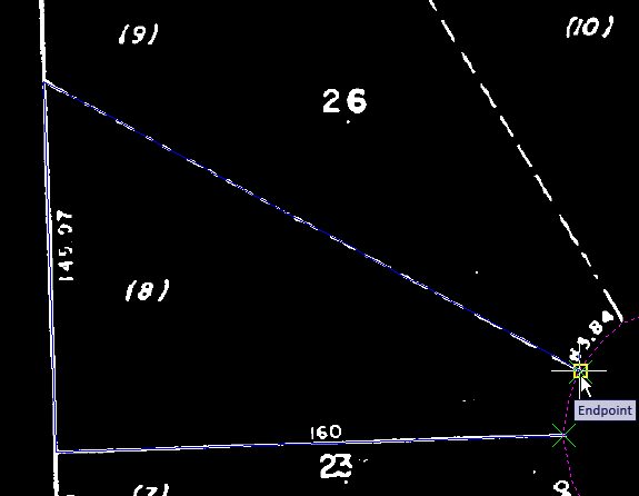

The Vector option allows you to follow a vector polyline when lines or boundaries overlap.
These points specify the direction and distance to follow on the vector polyline. The AutoCAD Endpoint OSNAP is activated for these point selections.
The lot lines for Lot 8 were converted to a single polyline.
