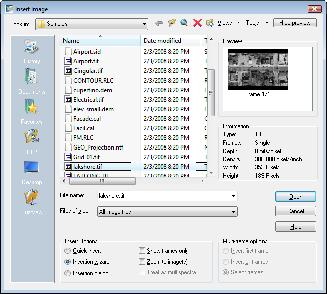

  2. To display the Insert Image dialog box, click RasterInsert.
  3. From the Files of Type list, select All Image Files.
  4. If necessary, navigate to the \Tutorial2 folder.
  5. Select the image file FoundationDetail_01.tif.
  6. Review the values shown for each parameter in the Information box.

    Position and insert the image using the Insertion Wizard
  7. Under Insert Options select the Insertion Wizard option.
    Also under Insert Options, ensure that Show Frames Only is not selected.
  8. Click Open to display the Pick Correlation Source dialog box.
    This dialog box is the first dialog box of the Insertion Wizard. When you choose a correlation source, the dialog box shows the insertion point, rotation, and scale associated with the selected correlation source.
  9. Accept the default correlation source, Image File, and click Next.
  10. Change the rotation value to 90 and click Next.
  11. Verify the AutoCAD values and click Apply.
  12. Click Finish to insert the image.
