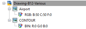

As shown in the following figure, the tree view displays two object types:
Image insertion
Color map
If you add two or more insertions of the same image, digits are appended to the image name, such as View:1, View:2.
