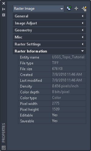

View image properties
This example shows the appearance of the Properties window when an image is selected. Raster Image is selected, and the image data appears at the end of the properties list in the Information section.
View the edit status of an image
The Edit Status dialog box indicates that this image can be edited and saved. When an image cannot be edited or saved, you can open the Edit Status dialog box to determine why.
