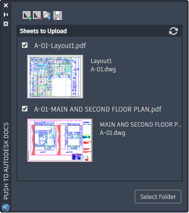

    The Push to Autodesk Docs palette opens. By default, all layouts for the current drawing are added to the palette and are selected.
  3. Create a list of sheets available to upload to Autodesk Docs using these icons:
    - select a drawing to add the layouts to the list of available sheets
    - remove the selected layouts from the list of sheets
    - load a previously saved list of sheets
    - save the current list of sheets to a file for easy retrieval
    Note: Right-click for a shortcut menu.

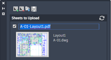

  4. Edit the PDF file names as needed. By default the PDF file name is <drawing name>-<layout name>.PDF.
  5. Select or clear the check boxes to define which sheets you want to upload as PDFs to Autodesk Docs.

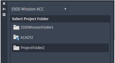

  6. Click Select Folder.
  7. Select the project from the drop-down menu that you want to upload the AutoCAD drawings as PDFs to.
  8. Navigate to and select the folder within project.
    • Single click a folder name to select a folder for upload.
      Note: Do not double-click a folder to select it as the upload location.
    • Indicates the folder contains sub-folders. Double-click to see a list of its sub-folders.
    • Double-click to go back one folder level.
  9. Click OK.
