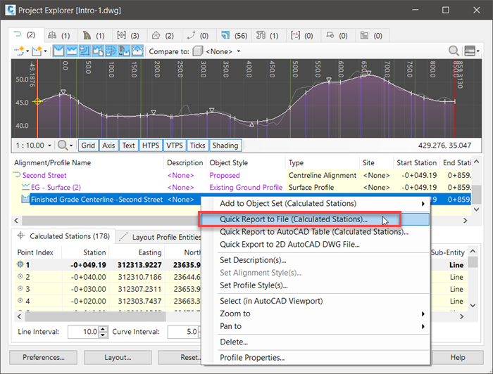

  1. From the Civil 3D ribbon, select the Add-Ins tab and click Launch Project Explorer to and open the Project Explorer window.
  2. On the Alignments tab of the Project Explorer window, locate the alignment Second Street, and right-click the associated profile: Finished Grade Centerline - Second Street Design.
  3. Select Quick Report to File from the right-click menu.

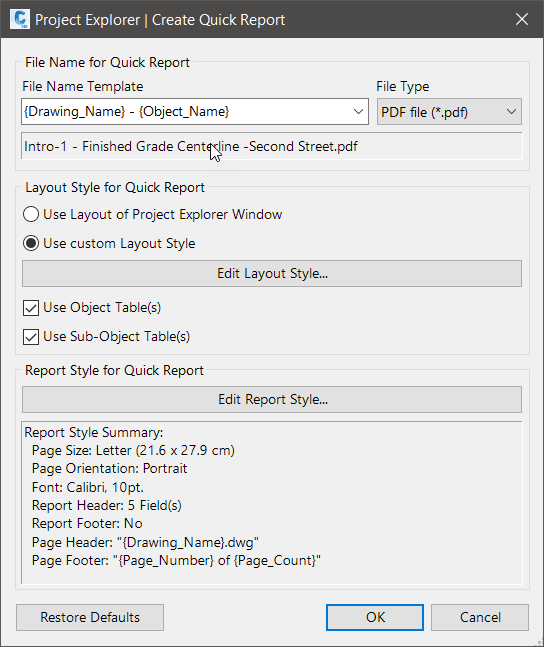

The Create Quick Report dialog opens.
Configuring your quick report
To generate a Quick Report you need to choose a file type for the report, then configure the content and layout of the report using a Layout Style and a Report Style.
Layout Styles define the heading, visibility, and order of every column of data in the report. The units of numerical values can also be controlled from a Layout Style.
Report Styles define the page formatting, fonts, table style, and header/footer content of outgoing reports.
Layout and Report Styles can be saved and retrieved at any time, but for this tutorial you will define your requirements manually.
  1. Ensure that the File Type drop down list is set to PDF File. Note that the file name of the outgoing report file can be derived from a series of dynamic variables during the creation process, or you can specify a fixed file name in this dialog. By default, the report file name will be made up of a combination of the drawing name and selected object name.
  2. Change the Layout Style setting to Use custom Layout Style, then click the Edit Layout Style button.

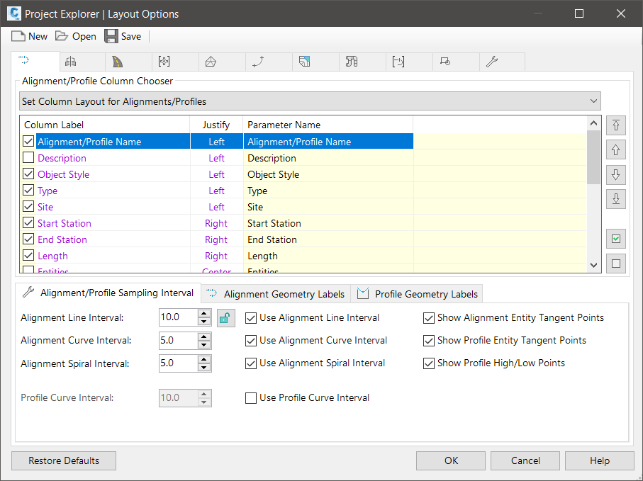

  1. In the Alignments tab of the Layout Options dialog box, ensure that Set Column Layout for Alignments/Profiles is selected.
  2. From the list view, ensure that just the first seven columns are selected: Alignment Name, Type, Object Style, Site, Start Station, End Station, Length.
  3. At this point, you may rename or reorder any of the selected columns to match the standards in your organisation. Columns may be renamed by double-clicking on the required label, or by right-clicking and selecting Rename from the right-click menu.
  4. Change the drop-down list on the Alignments tab to Configure Column Layout for Alignment Entities/Points .
  5. From the list view, ensure that just the following columns are selected: Point, Station, Easting, Northing, Elevation, Bearing, Alignment Radius, Gradient, Profile Radius. Rename and reorder any of the selected columns to your own requirements.
  6. From the Alignment/Profile Options controls, set a desired Line, Curve, and Spiral interval for the outgoing Quick Report.

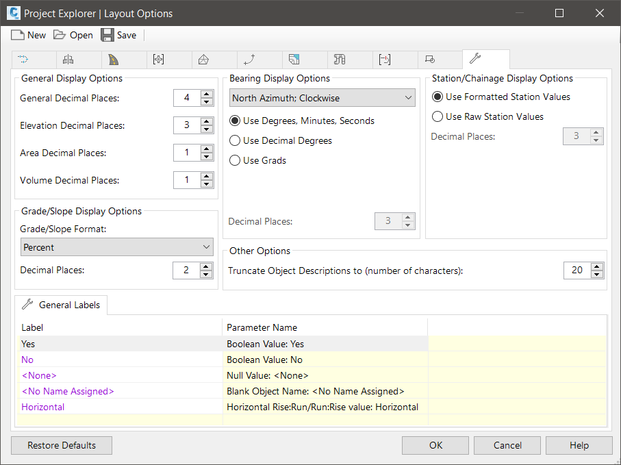

  7. Select the General tab and note the options here to set the format of numerical values such as angles/bearings, stations, elevations, and slopes. Changes applied here will only affect the outgoing Quick Report.

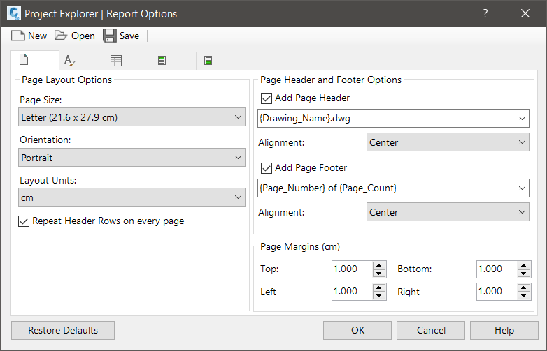

Report style options
Next, you'll specify the style of the outgoing report.
  1. Click the Edit Report Style for Quick Reports button. The Report Options dialog opens.
  2. On the Page Options tab, set the Page Size to A4, and the page orientation to Portrait.
  3. On the Font Options tab, set the Preferred Font to Corbel and the font size to 10pt.
  4. On the Table Options tab, set the Header Row Background Color to Pale Yellow, or a color of your choice.
  5. Optionally, on the Report Header tab, select the Add Image to Header checkbox and click the Browse button to select a company logo image file from your computer.
  6. Finally, click OK to close the Report Options dialog and return to the Quick Report dialog.

On the Alignments tab of the Project Explorer window, relocate the alignment Second Street, and right-click the associated Finished Grade Centerline - Second Street Design Profile.

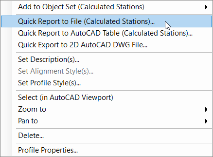

Ensure that the Calculated Stations sub-object tab is selected, then right-click the selected profile and select Quick Report to File (Calculated Stations) from the right-click menu.
The Create Quick Report dialog box opens.
Configuring the report for export to Excel
  1. Change the file type to XLSX file to generate an Excel file. As you have previously configured your report settings, you can just accept the current layout style and report style, or you can make some minor adjustments if you wish.
