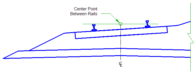

By default, the attachment point is at the centerline between the rails. The track can be moved relative to this point using the subassembly parameters.

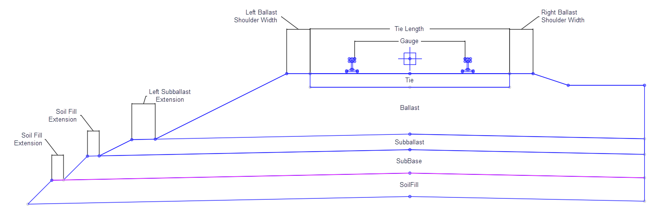

Ballast Shoulder Width (Left and Right) The distance from the end of the tie to the beginning of the ballast side slope. Numeric, non-negative 12"
305 mm
Ballast Side Slope (Left and Right) The slope of the side of the ballast material. The slope of the top of the ballast material matches the slope of the tie that results from cant. Slope, non-negative 2:1
Subballast Depth The depth of the subballast material Numeric, non-negative 8"
203 mm
Subballast Top Slope (Left and Right) The top slope of the left and right sides of the subballast with the centerline of the subassembly as the hinge point. Slope, non-negative 40:1
Subballast Side Slope The slope of the side of the subballast material. Slope, non-negative 2:1

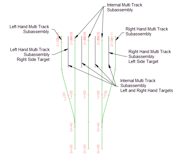

This subassembly works in multi-track situations in conjunction with the Internal Multi Track Subassembly and/or the Right Hand Multi Track Subassembly. With these subassemblies, each rail line has its own alignment and profile. Place this subassembly on the left hand alignment and profile. Control the right edge location of the subassembly with the input parameters or with the target parameters provided. Target lines between the left hand alignment and the internal rail alignments.

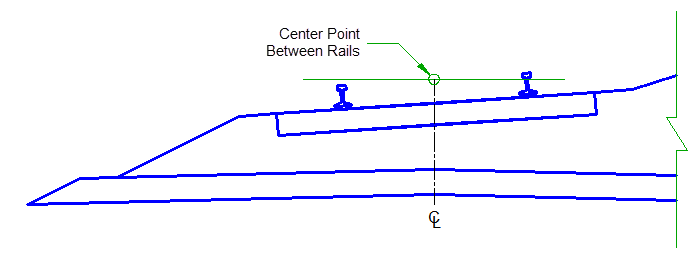

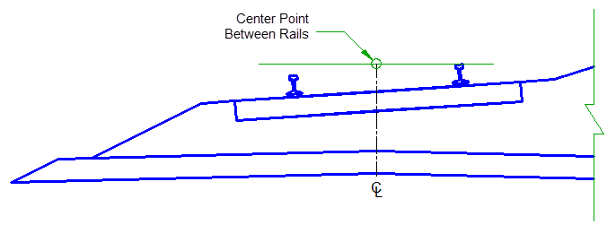

When you apply rail cant information to the alignment baseline, the rails rotate accordingly. The point about which they rotate depends on the Pivot Method setting contained in the cant information for the alignment. If you set a Pivot Method to Low Side Rail, then the rail on the inside of the curve is held at track elevation and the elevation of the outside rail is adjusted an amount equal to the cant value.
If you set the Pivot Method to High Side Rail, then the rail on the outside of the curve is held at track elevation and the elevation of the inside rail is adjusted an amount equal to the cant value.
If you set the Pivot Method to Center Baseline, then both rails are adjusted an amount equal to half the cant value, the outside rail upward and inside rail downward.

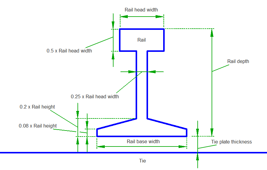

Rail Detail
The rail shape used in this subassembly is a simplified approximation of industry standard rail shapes and dimensions. Rail Head Width, Rail Depth, and Rail Base Width are available as input parameters and are used to derive the remaining approximated dimensions.

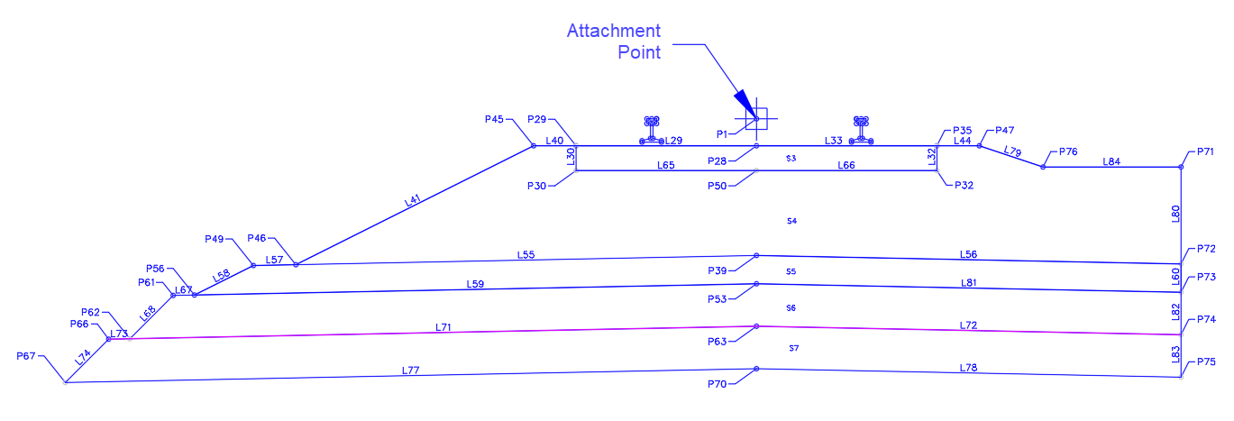

Point, Link, and Shape Codes
The following table lists the point, link, and shape codes for this subassembly that have codes assigned to them. Point, link, or shape codes for this subassembly that do not have codes assigned are not included in this table.
Point, Link, or Shape
Code
Description
P1, P4-P21 Rail Rail
P2 Cl_Rail Centerline of Rail
P3 Gauge_Line,Rail Gauge line (inside edge of top of rail)
P28-P32, P60 Tie Tie
P45, P54-P55, P47, P71-P72 Ballast Ballast
P50, P53, P73 Subballast Subballast
P63, P65, P74 SubBase SubBase
P68-P70, P75 SoilFill SoilFill
L1, L2 Top_Rail, Rail Top of rail
L3-L28 Rail Rail
L29-L33, L65-66 Tie Tie
L40-L41, L44, L55-L56, L79, L88 Ballast Ballast
L57, L60-L62, L80 Subballast Subballast
L70-L72, L81 SubBase SubBase
L76-L78, L82 SoilFill SoilFill
S1, S2 Rail Rails
S3 Tie Tie
S4 Ballast Ballast
S5 Subballast Subballast
S6 SubBase SubBase
S7 SoilFill SoilFill
