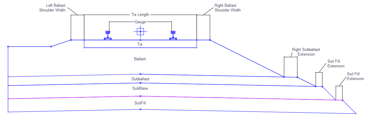

Behavior
This subassembly works in multi-track situations in conjunction with the Internal Multi track Subassembly and/or the Left Hand Multi Track Subassembly. With these subassemblies, each rail line has its own alignment and profile. Place this subassembly internally to the right hand alignment and profile. Control the left edge location of the subassembly with the input parameters or with the target parameters provided. Target lines between the right hand alignment and the internal rail alignment.
When you apply rail cant information to the alignment baseline, the rails rotate accordingly. The point about which they rotate depends on the Pivot Method setting contained in the cant information for the alignment. If you set a Pivot Method to Low Side Rail, then the rail on the inside of the curve is held at track elevation and the elevation of the outside rail is adjusted an amount equal to the cant value.
If you set the Pivot Method to High Side Rail, then the rail on the outside of the curve is held at track elevation and the elevation of the inside rail is adjusted an amount equal to the cant value.
If you set the Pivot Method to Center Baseline, then both rails are adjusted an amount equal to half the cant value, the outside rail upward and inside rail downward.
The Minimum Ballast Depth value applies at the location of the minimum clearance between the tie and subballast. The Subballast Top Slope parameter independently controls the subballast top slope . The Baseline to Subballast Crown parameter controls the location of the subballast crown.

Point, Link, and Shape Codes
The following table lists the point, link, and shape codes for this subassembly that have codes assigned to them. Point, link, or shape codes for this subassembly that do not have codes assigned are not included in this table.
Point, Link, or Shape
Code
Description
P1, P4-P21 Rail Rail
P2 Cl_Rail Centerline of Rail
P3 Gauge_Line,Rail Gauge line (inside edge of top of rail)
P28-P32, P60 Tie Tie
P45, P54-P55, P47, P71-P72 Ballast Ballast
P50, P53, P73 Subballast Subballast
P63, P65, P74 SubBase SubBase
P68-P70, P75 SoilFill SoilFill
L1, L2 Top_Rail, Rail Top of rail
L3-L28 Rail Rail
L29-L33, L65-66 Tie Tie
L40-L41, L44, L55-L56, L79, L88 Ballast Ballast
L57, L60-L62, L80 Subballast Subballast
L70-L72, L81 SubBase SubBase
L76-L78, L82 SoilFill SoilFill
S1, S2 Rail Rails
S3 Tie Tie
S4 Ballast Ballast
S5 Subballast Subballast
S6 SubBase SubBase
S7 SoilFill SoilFill
Coding Diagram
