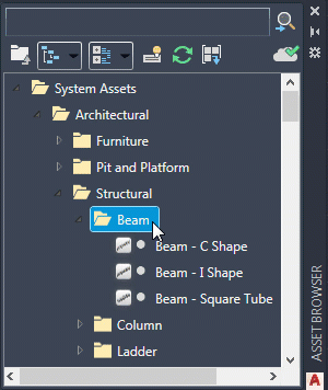

  1. Select any folder from the Asset Browser in AutoCAD.
  2. Right click the selected folder to access the list of context-menu commands.
  3. Select Update Assets.
All of your assets are up to date with the latest asset data.

To download Factory assets from the Asset Browser
  1. Select any folder, or list of Search Results from the Asset Browser in AutoCAD.
  2. Right click the selected folder, or Search Results node to access the list of context-menu commands.
  3. Select Download Assets from the menu.
All of the downloaded assets are now available for use and reuse in your Factory layout.

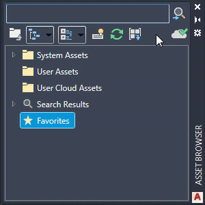

To bulk update or download assets from Asset Browser Search Results
Alternatively, you can select to bulk update or download a list of assets in the Search Results from within the Asset Browser.
  1. Type in your search criteria and press Enter.
  2. Select and right click on the node in the Asset Browser to access the context-menu options.
  3. Hover over the Factory option to extend the context menu and select Update Assets or Download Assets.
