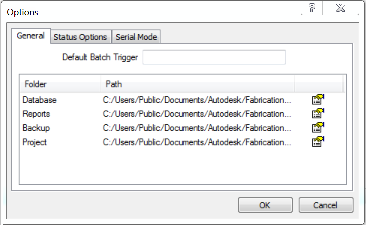

- Click the General tab to set the main triggers for Tracker to execute.
Trigger key sequences are events which when keyed/scanned via bar codes, then process the relevant command.
- The
Default Batch Trigger allows you to specify the batch trigger that is used by default. The Batch Trigger is the string that intiates the Batch Triggered event, so that when that trigger string is scanned, the actions associated with the “Setup Default Action” are executed.
- Set the Folder and Path for Database, Reports, Backup, and Project. For example, the reports that are available are determined by the Reports path on the General tab.

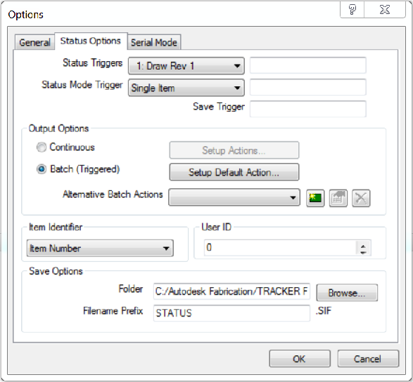

- Click the Status Options tab.
- Specify the Status and Trigger options as follows:
Enter Mode Trigger relates to this tab's selection when scanning "Status Mode Trigger" from your scanner or entry. This trigger would normally be set to "STATUS".
- Status Triggers: You can specify a trigger for each status that exists in the database. These triggers allow selection of the status when entering the item's status change. The example above shows the Manufacturing status with a trigger of "MANUF". This trigger can be assigned to your printed worksheet so that when scanned/keyed, the status is changed in the Tracker Takeoff dialog. This works will all other statuses, as long as they have their unique trigger strings set. For example:

- Status Mode Trigger can be specified as follows:
Single Item: Selects each item one at a time, and exports the SIF file containing individual items.
Spool: Allows you to specify one item in a Spool Drawing for the software when the SIF file has been updated to the master database. Also to update all items relating to the same spool entry as that one item scanned in. (Item Spool) if continuously updating spooled drawings or combinations or items in the same run. Spool can be used to save entry/scanning of each individual item.
- Status: Specifies that status that is used for the trigger.
- Save Trigger: This is the trigger text that when scanned saves the current job.
Specify the Output Options as follows:
- In the Item Identifier section, specify the options as follows:
Item Identifier can be determined in three levels. The identifier is the criteria for how Tracker will find the items for then changing its statuses.
- Item Number: the number on the item allocated by the user at takeoff. The criteria would be Job Number and then Item number in the job.
- Item Handle: Handle is a hexadecimal entry automatically assigned per job against each item. Criteria would be Job Number and then Item Handle.
- Item GUID: Item GUID is a unique number assigned to the item that contains job and item. No GUID across jobs are the same, and these are automatically assigned to each item.
User ID: In situations where there are multiple scanning stations, and multiple people scanning on the shop floor, you can assign a unique User ID for each scanning device or station. This is useful for tracking and logging which user (scanner or station) has assigned each status change or scan.

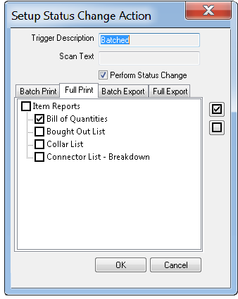

Save Options are determined so that Tracker can export the SIF file to a destination folder and prefix string for the SIF file.
Always Output Full Job and Database Exports: Can only be selected when in Batch (Triggered) mode, and will print/export all items in the job each time the trigger for Print is given.
